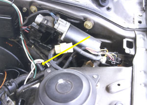

Key On Engine Off Self Test: Turn the ignition switch ON, but do not start the engine. When you're ready to start the test, ground the Self-Test Input (STI) connector. It's a red wire with a white stripe located just behind and slightly to the right of the right strut mount (See Image Below).
Key On Engine Running Self Test: Start the engine and allow it to idle. When you're ready to start the test, ground the Self-Test Input (STI) connector. It's a red wire with a white stripe located just behind and slightly to the right of the right strut mount (See Image Below).
