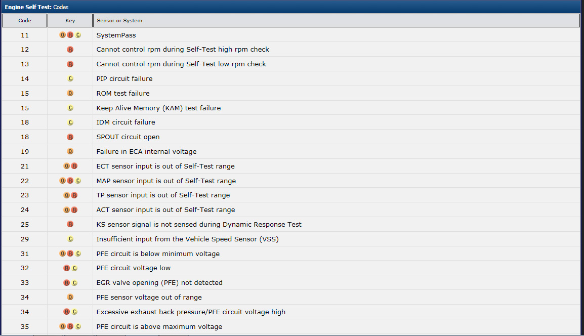

The pulses on the voltmeter and the flashes on the MIL light translate into two digit codes. To simplify things, we'll call all flashes and pulses, pulses. There are two types of pulses. A long pulse is a pulse that lasts 1-1/2 seconds. A short pulse is a pulse that lasts a 1/2 second. These are pretty distinguishable. The long pulse represents the first digit of a two digit code and the short pulse represents the last digit. So, if there are three long pulses followed by four short pulses, that would be the number 34. If there isn't any long pulse, the number is less than ten. Eight short pulses with no long pulse would be an 8 code. If there is a long pulse, but no short pulse, the code is 10. If there is more than one code, each code will be separated by a 4-second pause.
Continuous Memory Codes are codes that appear while normal running and are stored by the computer for a period of time. During the Key On Engine Off Self Test, after all the codes are displayed, there will be a six second pause, a single flash, followed by another six second pause. Any Continuous Memory Codes will then be displayed in the same fashion as the regular codes. Continuous Memory Codes will only display once, before being erased, so make sure you're ready for them.
If there are no problems found, code 11 will be displayed.

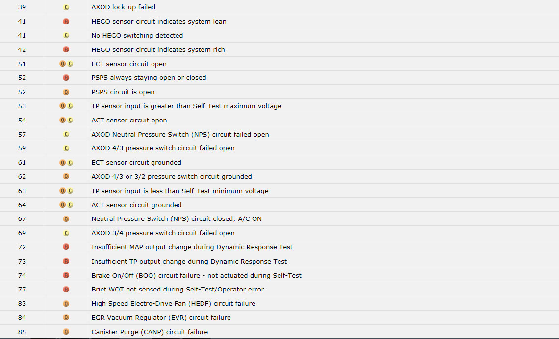

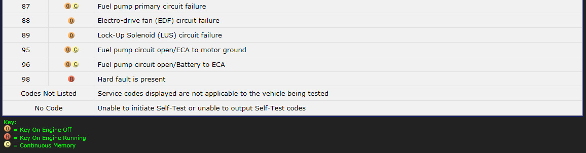

Error Codes
