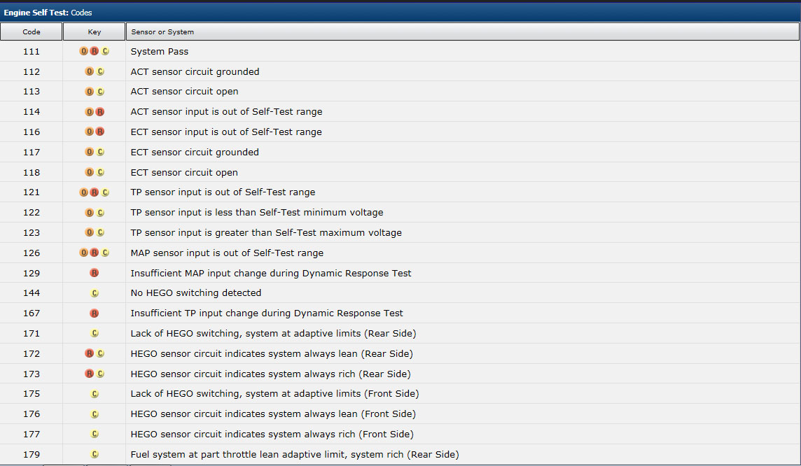

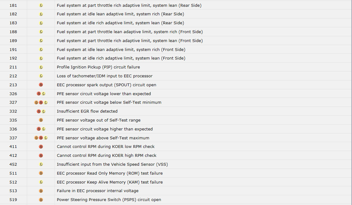

Interpreting the Codes The pulses on the voltmeter and the flashes on the MIL light translate into three digit codes. To simplify things, we'll call all flashes and pulses, pulses. There are two types of pulses. A long pulse is a pulse that lasts 1-1/2 seconds. A short pulse is a pulse that lasts a 1/2 second. These are pretty distinguishable. The long pulse represents the first two digits of a three digit code. The short pulse represents the last digit. The number 327 would be 3 long pulses, a pause, 2 long pulses, a pause, 7 short pulses. If there is more than one code, each code will be separated by a 4-second pause.
Continuous Memory Codes are codes that appear while normal running and are stored by the computer for a period of time. During the Key On Engine Off Self Test, after all the codes are displayed, there will be a six second pause, a single flash, followed by another six second pause. Any Continuous Memory Codes will then be displayed in the same fashion as the regular codes. Continuous Memory Codes will only display once, before being erased, so make sure you're ready for them.
If there are no problems found, code 111 will be displayed.
Codes 327
