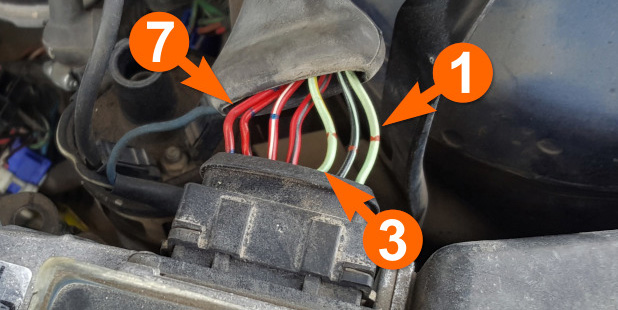

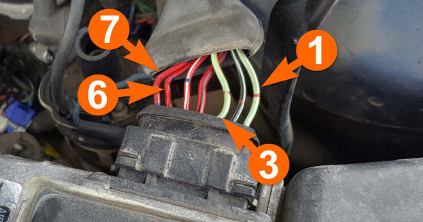

You'll notice that in the photo above, the VAF sensor's connector is numbered 1 thru 7. The only circuits that we are going to be concerned about in this tutorial are circuits 3, 4, and 6. Here's the description of each circuit below.
  • Number 1- Fuel pump switch circuit.
    Number 2- Fuel pump switch circuit.
    Number 3- Sensor Ground thru' the ECM.
    Number 4- 12 Volts.
    Number 5- 9 Volts.
    Number 6- VAF signal.
    Number 7- Air Temperature Sensor Circuit.

The wire that feeds power to your Mazda's vane air flow meter is the one labeled with the number 4 in the photo above.

This Ground is fed to the sensor via the wire identified with the number 3 in the photo above.

    Connect the black multimeter test lead to the number 3 wire shown in the photo above.
    This is the light green with yellow stripe wire of the connector.

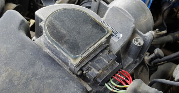

In this test section we're gonna' manually actuate the VAF sensor's measuring plate (vane) while we test the continuity of two specific terminals (on the sensor itself).
If the VAF sensor is good, then your multimeter should register an Ohms value that will smoothly increase as you open the measuring plate and decrease as you close it.
These are the test steps:
  • 1
    Disconnect the vane air flow sensor's connector.
    2
    Place the multimeter in Ohms (Ω) mode.
    3
    Connect the multimeter leads (with a suitable tool) to the male spade terminals of the sensor that correspond to: Circuit Number 3 and Circuit Number 6.
    4
    Manually open and close the sensor's measuring plate (vane) as you watch the Ohms readings on the multimeter.
    5
    The range of the resistance (Ω) will be anywhere in the vicinity of 20 Ohms with the plate fully closed to 1000 Ohms with the plate fully open.

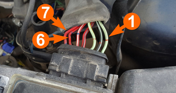

IMPORTANT: The VAF sensor must remain connected to its electrical connector to perform this test. For this reason you'll need to use a back probe or a wire-piercing probe. You can see an example of this tool here: Wire Piercing Probe.
OK, let's get started:
  • 1
    Connect the red multimeter test lead to the Number 6 wire as shown in the photo. This is the red with black stripe wire.
