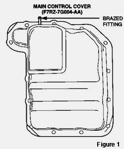

NOTE: BEGINNING JANUARY 1997, ALL CD4E TRANSAXLES CONTAIN A REVISED MAIN CONTROL COVER (F7RZ-7G004-AA), FIGURE 1, AND VENT TUBE ASSEMBLY (F7RZ-7034-CA FOR PROBE AND F7RZ-7034-BA FOR CONTOUR/MYSTIQUE), FIGURE 2. THIS NEW DESIGN WILL PREVENT FLUID FROM SEEPING FROM THE VENT. IF THE VENT HOSE IS KINKED OR BLOCKED INTERNALLY, FLUID WILL LEAK FROM THE TRANSAXLE FILL TUBE.

Fully seat straight end of tube onto brazed fitting on main control cover. Mount clamp securely onto brazed fitting to secure tube assembly (Figure 3).
