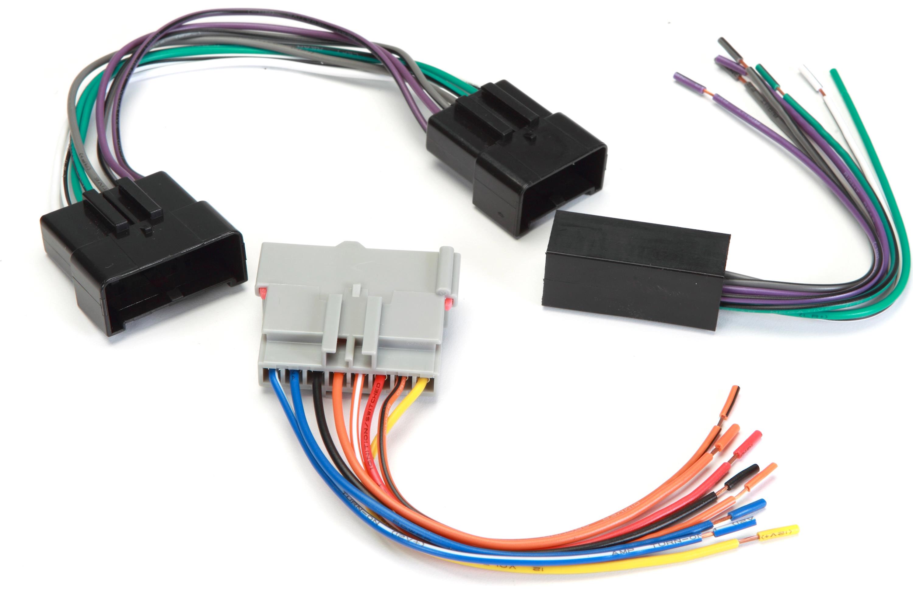

The premium sound system package that was offered with the Probe included an amplifier that delivered 20-watts per channel. It is located behind the right side quarter panel trim, near the B-pillar. Normally, installation kits will include a wiring harness that is used to bypass the factory amplifier. This, however, is unnecessary unless you are worried about loss of sound quality.

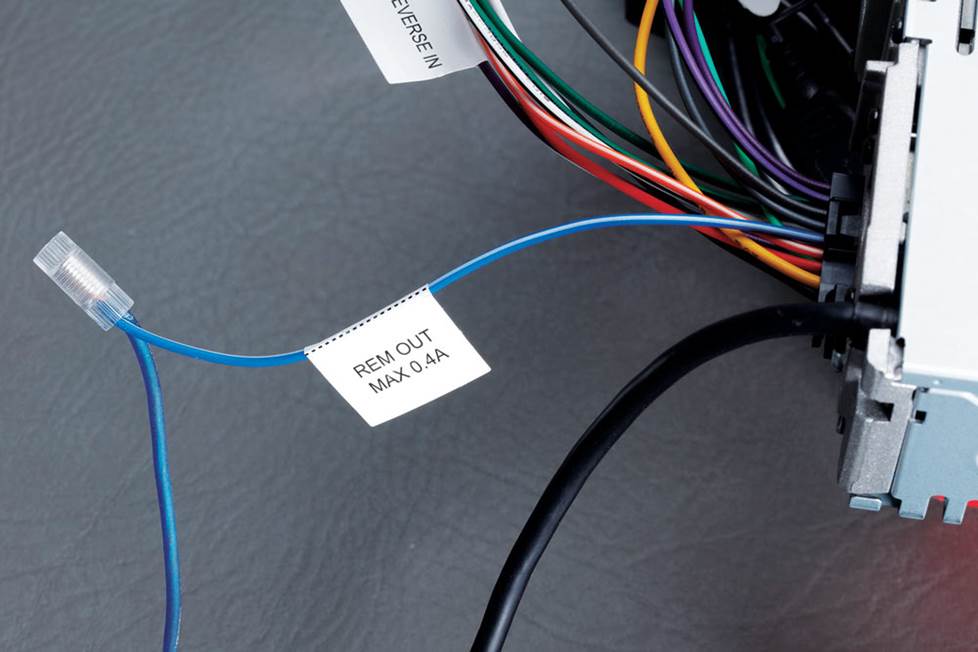

Find the red/green wire on the main radio connector.
Connect the red/green wire to the new stereo unit's amplifier trigger wire. If one is not available, connect it to the blue/white wire or blue remote wire.

Disconnect the electrical connectors from the amplifier and remove the three mounting nuts. Remove the amplifier from the vehicle or keep it in the vehicle and install the bypass harness that was included in your Metra wiring kit 70-5514. Or also if you have a factory eq or cd player, see the topic in the forum on car audio wiring.
